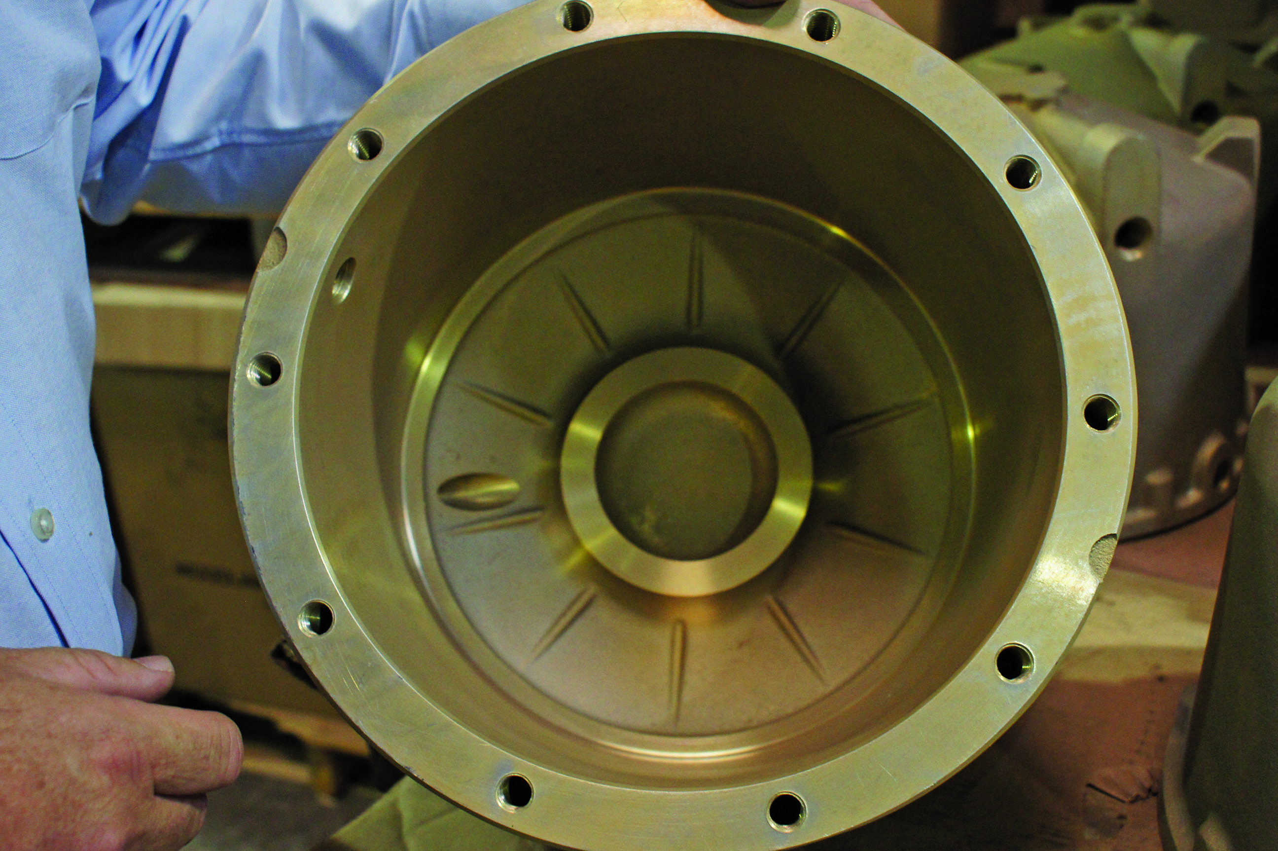

Woodland currently has two plants within four blocks of each other, with a combined square footage of 135,000 sq. ft. Complex, highly cored castings are their strong suit. Plant I houses the aluminum foundry, core room, air set molding cleaning room and the original heat treat operation. The highlights of the foundry are the cope and drag lines which consists of one set of CT-3 molding machines and one set of CT-7 machines. They can run a flask size of 26 x 26 up to 36 x 50. Other molding lines include squeezer and rotolift machines, giving Woodland the capability to meet its customer requirements.
Plant II is a large casting processing facility including nondestructive testing equipment, a coordinate measuring machine and targeting/qualifying fixtures.

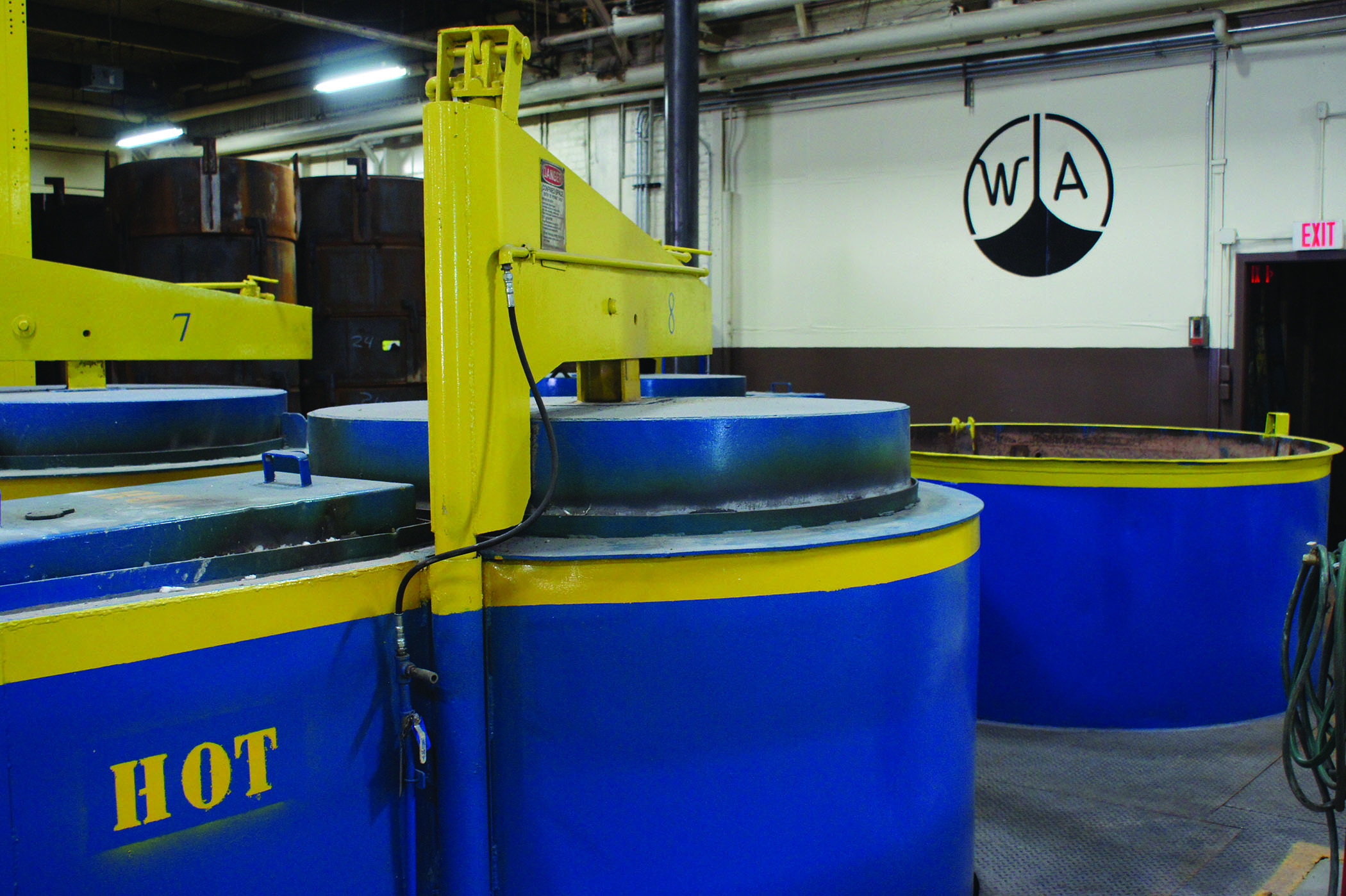

Recently, a second heat treat operation was installed consisting of three 65-in diameter solution furnaces and an 8 x 12 ft. walk-in oven.
The Benefits of Investment
A key tenet of Woodland is adaptability. It is important for a business to meet the needs of its customers and the direction of the market to keep a competitive edge. One area the company recognized as a capacity issue was heat treating, and the decision was made to add a second operation. This investment allowed the company to process larger castings and led to more efficient processing. The benefits include reduction in material handling, energy efficiency, and an overall reduction of CO2 emissions.
