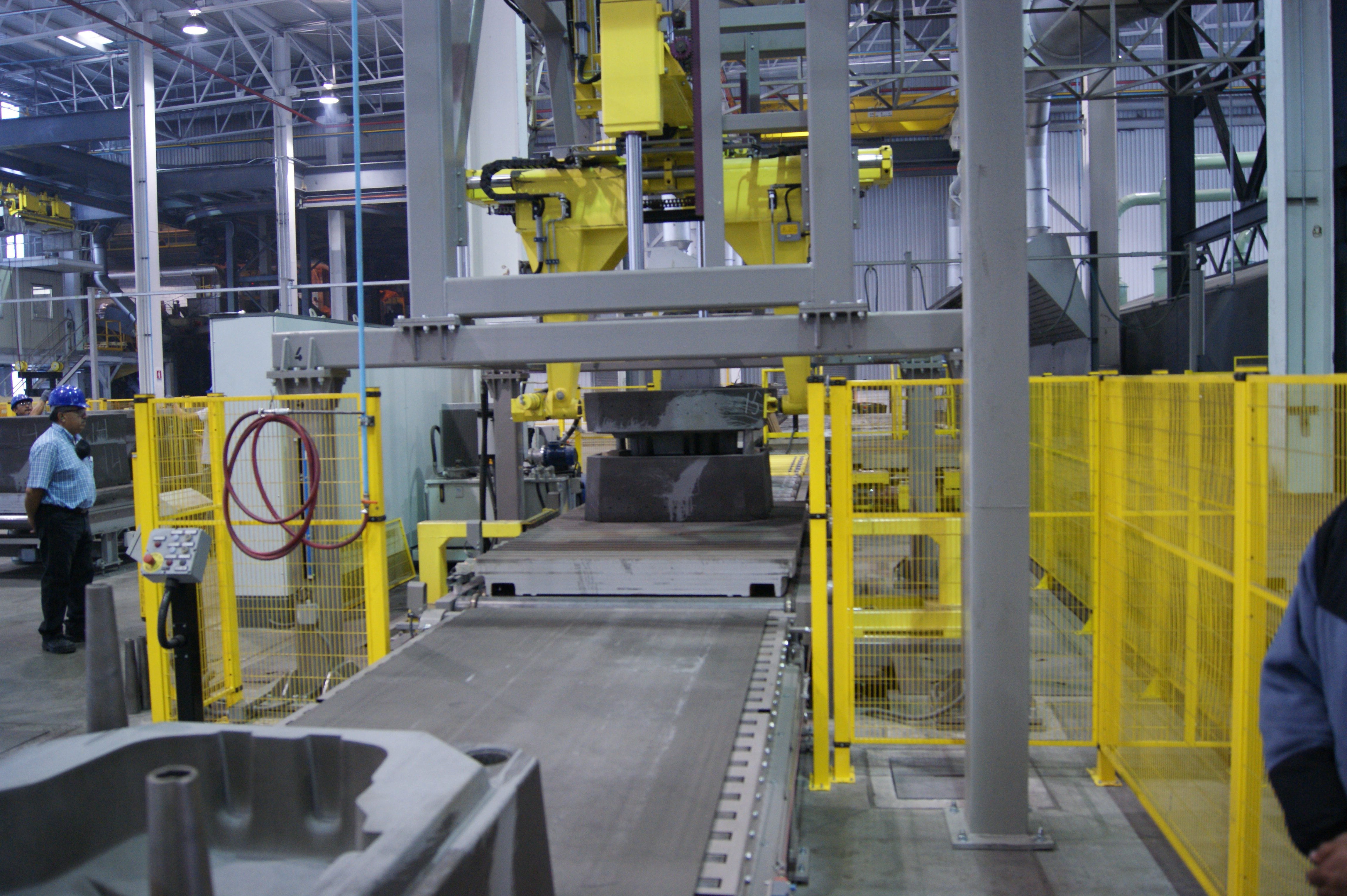

The December shutdown is used by Blackhawk for major projects. Last year, the company installed robotic cells for the grinding area. Every project has a timeline, and Blackhawk uses software so everybody can access a timeline on mobile devices. There is a project manager who follows the different activities during different days, and there are more meetings between Calderon and other managers for progress reports.
