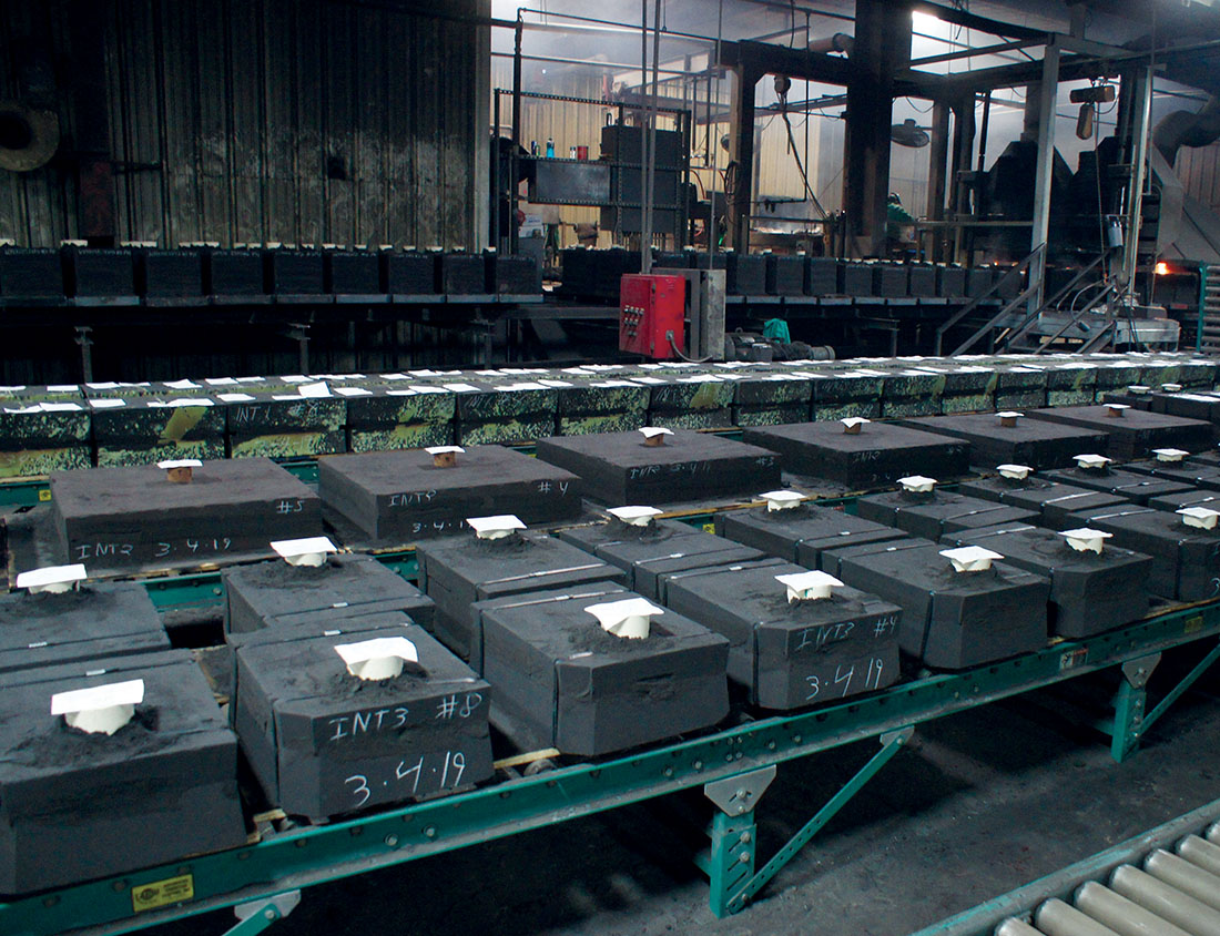

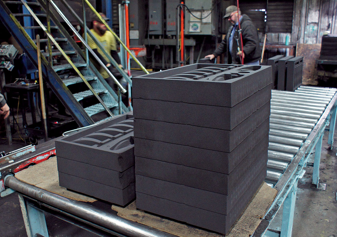

The undertaking includes creating the production timetable for Tonkawa’s cold box stack molding line and nobake molding line producing components in Ni-resist and abrasion-resistant irons as well as low-alloy carbon steel and manganese steels. The foundry can make castings at a wide range of volumes, including high volumes of small castings where multiple parts are produced per mold. It makes its own cores and offers some assembly.

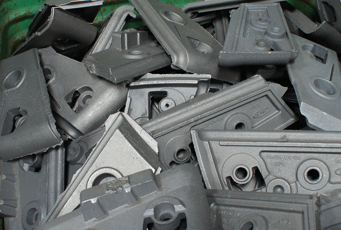

Now Tonkawa splits its production evenly among agriculture, shot blasting and general industry. Its mix is unique, meaning very few places in the central U.S. at Tonkawa’s size range pour these alloys.

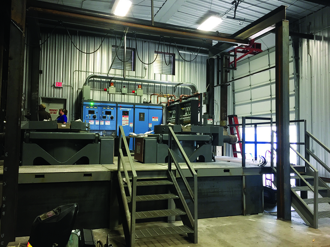

Because of the fire damage, the melt deck had to be reconstructed. During the reconstruction, Tonkawa opted to raise the entire deck to be on the same elevation and located the power supply, workstation and furnaces on one level. The foundry worked closely with AFS Corporate Members EMSCO (Massillon, Ohio) and Inductotherm (Rancocas, New Jersey) which specialize in helping metalcasting facilities with a melt operations crisis, to establish and implement a plan.
“Eliminating the steps and relocating the power supply further from the furnaces was a significant improvement to our melt deck,” Salisbury said.
The reconstruction added a second hoist to the deck, as well as another exit door and set of stairs. Tonkawa also added a dump-out pit below the furnace in case of failure.
