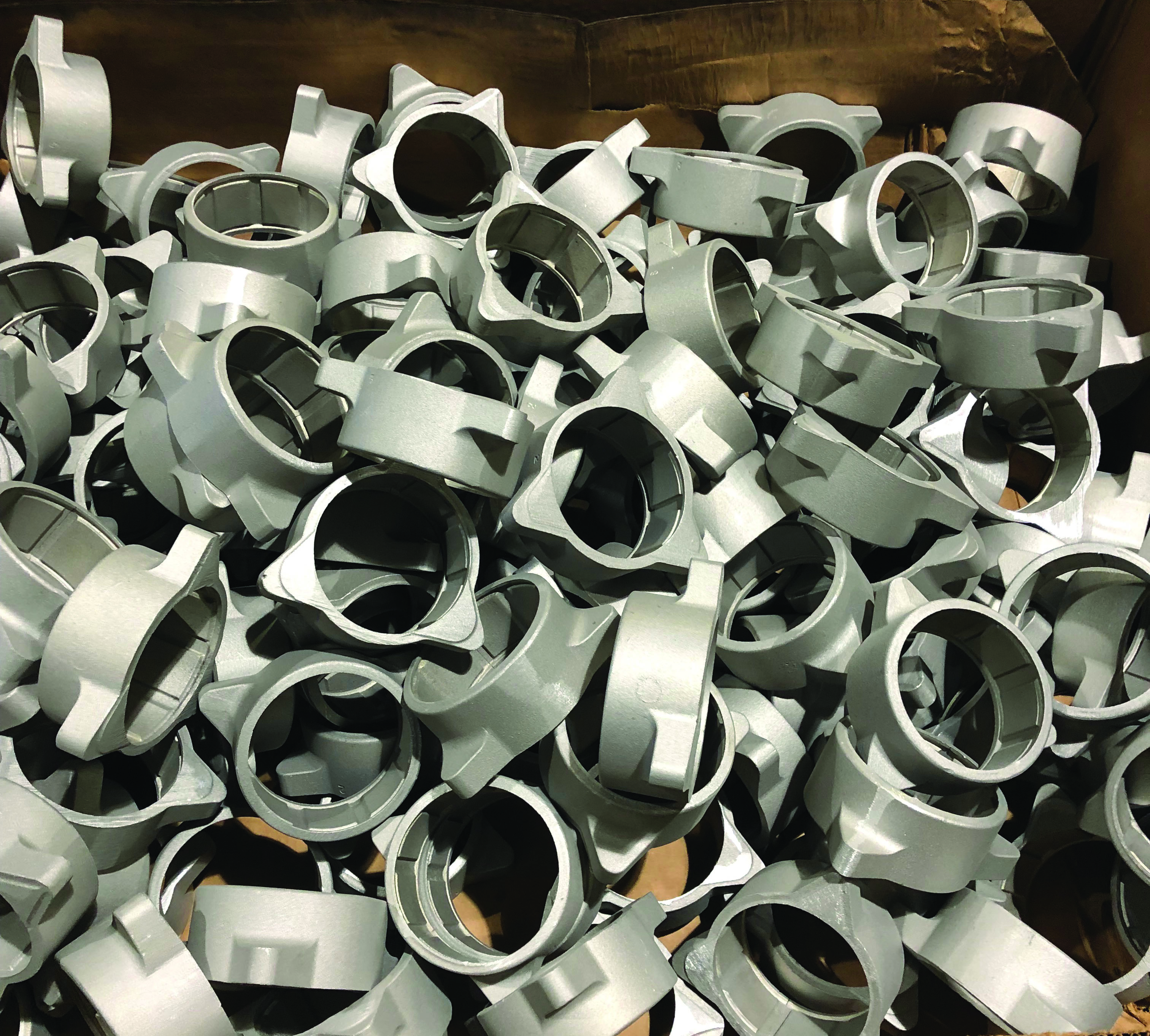

Manufacturer’s Brass & Aluminum Foundry provides castings for many industries, and stresses the importance of training to make sure the metal avoids contamination.
