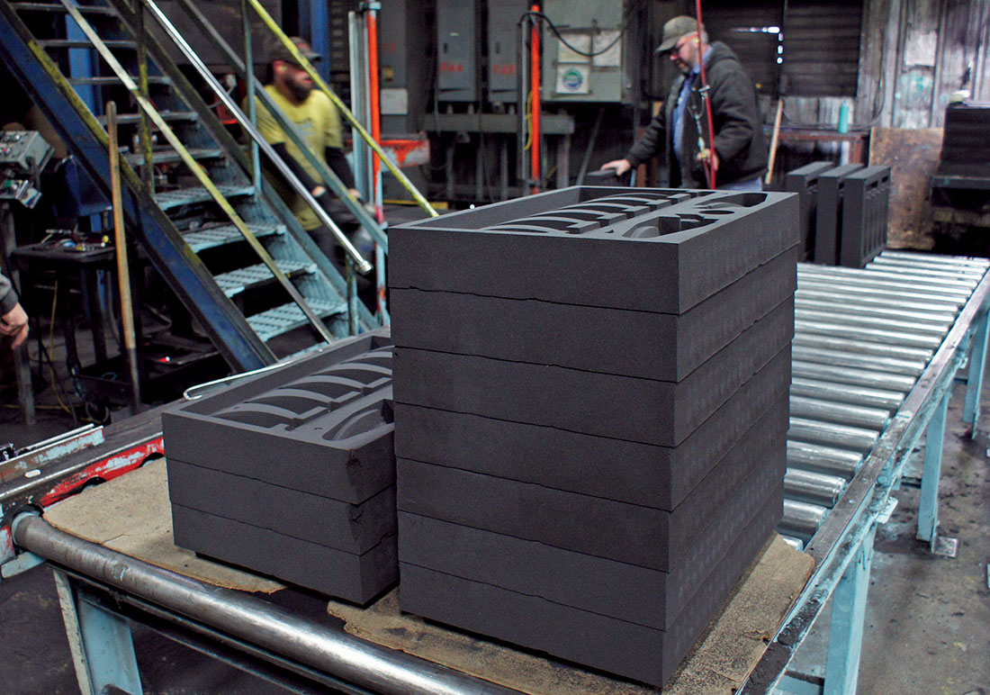

Tonkawa Foundry uses stack molding to cast multiple parts in a single pour.
