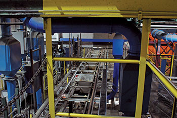

Up next was the core room sand mixing and distribution. Conducted over 2017-18, the project took multiple phases. Open conveyor belts, bucket elevators, and plows were removed. A pneumatic sand transporter takes sands from the existing silo to existing hoppers. By removing the plow process, the hoppers are enclosed. This means less equipment to maintain and has eliminated open transportation, which reduces silica exposure, labor for housekeeping, and potential contamination. A new binder handling system eliminated the use of 55-gallon drums and revitalized a gas generator room for the two-binder tote storage that is pumped to new-day tanks. The next phases of that project brought a new mixing system for 11 core machines.
