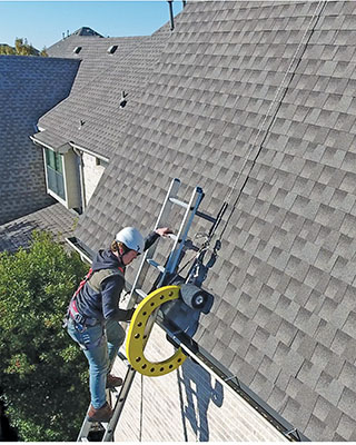

So, this trained musician-cum-lawn pro-cum-lights hanger became an inventor and set out to develop a non-penetrating hook device specifically designed to protect workers from falling off sloped roofs. Priority 1: He wanted a minimum of 7,200 lbs. of strength; Priority 2: He insisted on a solution light enough to be carried up a ladder.
Little did he know he was about to embark on over a decade’s journey before his 1,000-watt idea would emerge from various prototypes of dubious design and materials into the final “EVEOOK.” That’s the name of his Ballantyne Gear-branded system, all based on a 20-lb. cast aluminum, large C-shaped hook produced by AFS Corporate Member Carley Foundry in Blaine, Minnesota.
The device, which is attached to wheels and rope, hooks below the eaves on two opposite sides of a house. It’s installed from either the ground or a ladder (with fall protection) in as little as seven minutes by two people or under 15 minutes by one. Able to withstand twice the OSHA standard for weight force––10,000 lbs., not 5,000––EVEOOK meets ANSI Z359 standard for fall protection and restraint as well as other related OSHA standards. It also appears to be on its way to becoming the first engineered device in its category to meet the required standards in the state of California. In mid-August, Ballantyne said it was just weeks away from being commercially available.

The final EVEOOK part was cast in a semi-permanent mold for good solidification, along with two shell cores. Carley Foundry’s team would have preferred to specify one large pull box core because they have the necessary equipment, Oehrlein said, but given the constraints of using someone else’s tooling, Carley opted to outsource shell cores to avoid having to discard what they’d been dealt.
Then there was the small matter of material. Ballantyne believed A200 series was the way to go, but the Carley team knew the alloy couldn’t deliver the price and properties combo this customer required. Instead, they advocated A356-T6 and persuaded him it was a better choice.
“It’s a much cheaper and easier-to-use alloy,” said Oehrlein. “So we did that, and the parts have tested very well. We are getting properties out of our A356 about as good as you can hope for––you might say we get values that are well above published values for that alloy.”
A fundamental shortcoming in the hook’s early fabricated models was low torsional rigidity––no one falls in a perfectly straight line, and fabricated versions of the hook couldn’t stand up to pull forces that twisted against them. Carley corrected the issue by creating heavy walls where it would be highly stressed and thin walls where less stressed.
“It makes casting tougher so we had to do a bit of a balancing act,” said Oehrlein. “If you’re trying to gate a part in casting, it’s nice to have section thicknesses so that it’s easy to produce the part. You would think you’d need to have nice uniform walls everywhere. But nice uniform walls everywhere is very wasteful in a structural design. The engineering practice in casting is, never feed a thick section through a thin section––and we were kind of faced with that.”
To reduce weight, the EVEOOK has several circular holes. The part achieves near net shape, requiring just two holes to be reamed, which Carley performs in-house. They outsource painting and labeling then deliver ready-to-assemble castings to Ballantyne’s distribution warehouse in Colorado.
