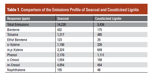

Seacoal of Kentucky origin was used for this study. This seacoal is currently used by many foundries throughout the U.S. Causticized lignite is a manufactured product. Commercially available causticized lignite was used for this testing.

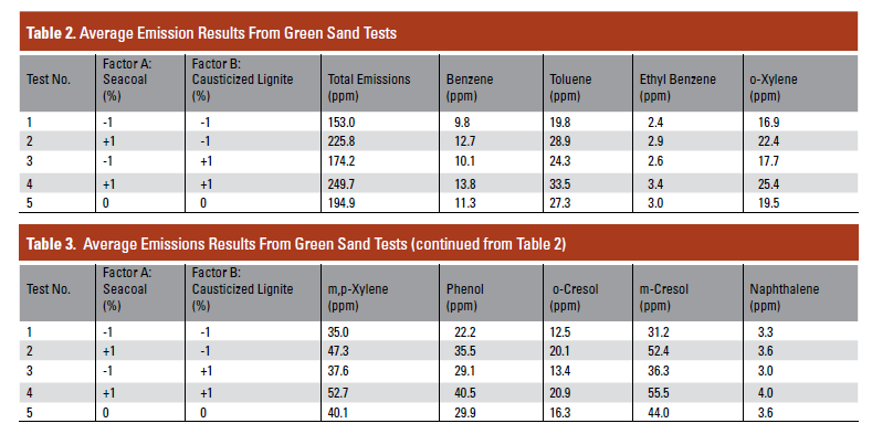

A experimental design (DOE) was conducted to estimate any main effects and/or interaction effects that exist between the amount of seacoal and the amount of causticized lignite a bentonite pre-blends used to prepare molding sands.
The test matrix was replicated at least three times. The results of the experiment were entered in the commercial DOE software and two-way ANOVA was performed at a 95% confidence level. The statistical software advises that the model overall is statistically significant based on the F-values and p-values. The F-value for each term was high, indicating the variation between the groups in the design was much higher than the variation within the groups of the design.
When the F value is larger than a predetermined F value based on the degrees of freedom for the terms between the groups and within the group, the term is considered significant. The interaction term AxB was removed from the model because it was not significant. The correlation coefficient for the model (R2) was 0.965, indicating the model can account for approximately 96% of the variation seen in the total emissions response as a function of the percentage of seacoal and causticized lignite added to the pre-blend. The ANOVA results for each of the nine individual compounds showed statistically significant models as well and indicated both % seacoal and % causticized lignite in the pre-blend are main factors while the interaction effect between seacoal and causticized lignite was not significant in predicting the variation in the total emissions response. The R2 values for the individual compounds ranged for 0.822 to 0.986.

The coded prediction equation generated from the statistical analysis of the variance is shown as Equation 1.
Total Emissions coded (ppm)=37.85 x Seacoal %+10.37 x Causticized Lignite %+199.0
The coefficient for % seacoal, 37.85, is 3.6 times larger than the coefficient for % causticized lignite, 10.37, indicating that in this model seacoal will contribute 3.6 times as much to emissions as an equivalent amount of causticized lignite on the coded scale. This was in good agreement with the results obtained when comparing the total emissions generated from the seacoal or the causticized lignite in the absence of other materials. That ratio was approximately 4.1 as calculated from the data.
The uncoded prediction equation shown here indicates that a substitution of 3-5% of the seacoal with causticized lignite could yield a potential reduction in emissions between 9-15%.
Total Emissions predicted (ppm)=8.90 x Seacoal %+2.30 x Causticized Lignite %-0.60

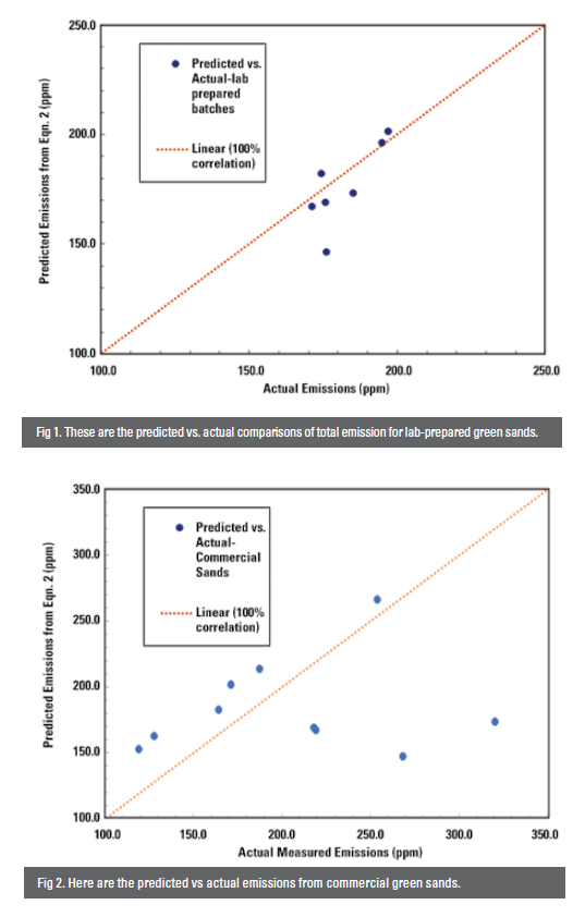

The normal plot of the residual analysis generated by the DOE software provides further confirmation of the significance of the model. Equation 2 was used to predict the emissions for additional lab-prepared green sands which were compared to the measured values (Fig. 1). The model predictions were within 5% of the measured value for five of the seven confirmation test batches.
Additionally, Equation 2 was applied to predict the emissions results of 10 commercial foundry green sands available in the laboratory (Fig. 2). The agreement between predicted and actual values for commercial green sands was lower than with the labprepared samples. This was somewhat expected. Many other variables that can contribute to green sand emissions were not addressed in the experimental design, such as core sand concentration, additional carbonaceous sources (e.g. gilsonite), parting sprays, and mold coatings and washes.
