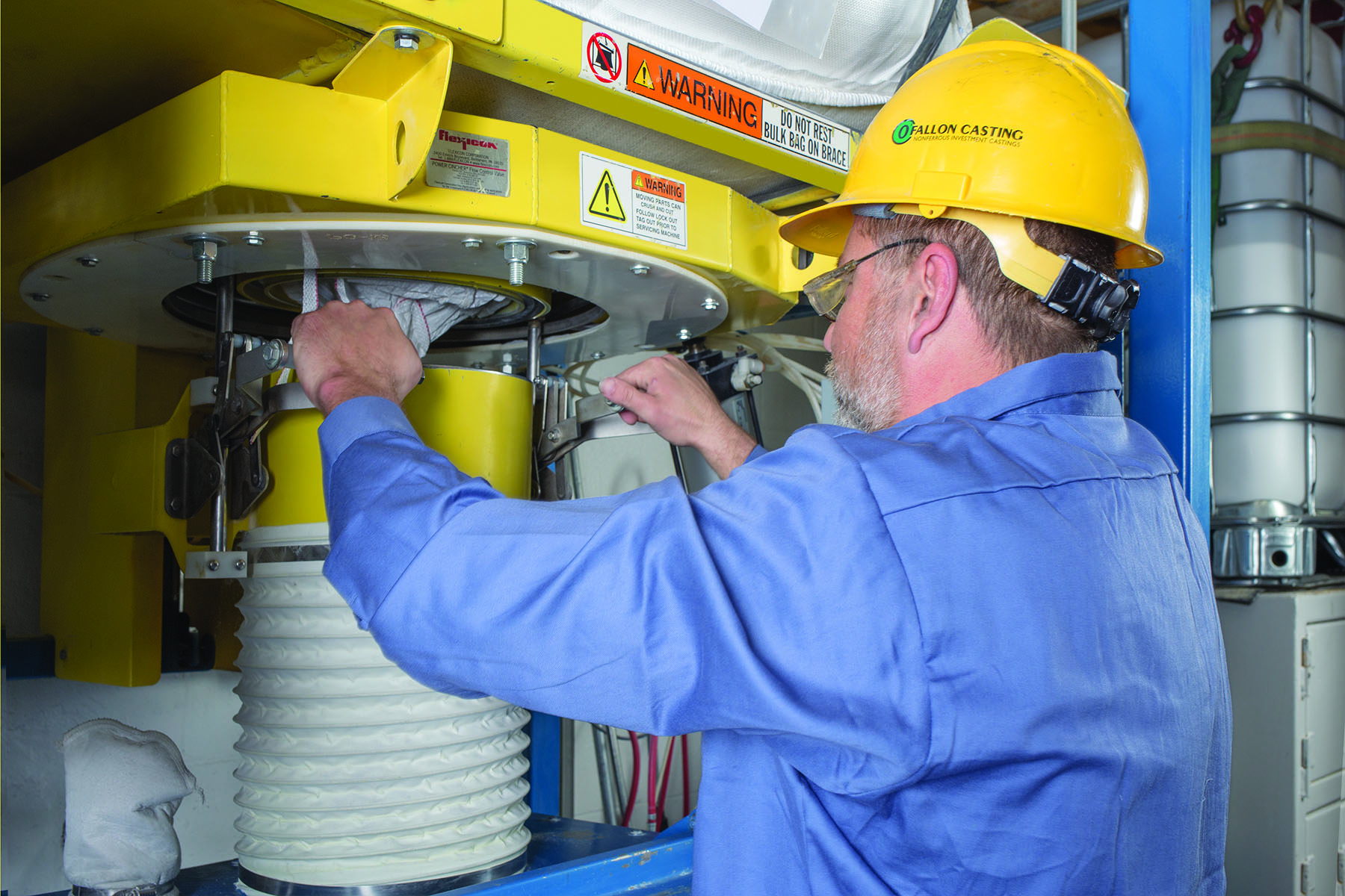

Bulk bags are delivered to each discharger by forklift and then loaded into the frame using a hoist and trolley that travels on a cantilevered I-beam. Next, a SPOUT-LOCK clamp ring atop a TELE-TUBE telescoping tube is raised pneumatically and secured to the bag spout. This serves to both contain airborne dust and maintain continual downward tension on the bag as it empties and elongates, promoting discharge from the bag.

Once the bag spout is secured by the Spout-Lock clamp ring, the Tele-Tube telescoping tube applies constant downward tension as the bag empties and elongates to promote complete discharge and contain dust.
“Those features were major considerations for us,” Cavins said. “We wanted to make sure that it was discharging from the bulk bag smoothly and that there wasn’t a lot of dust created where the hoppers are.”
